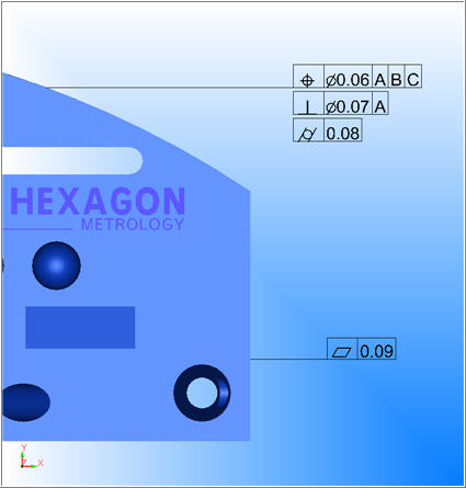

PC-DMIS lets you work with CAD GD&T callouts that are part of your CAD model in the Graphic Display window. You can show and hide these callouts, reposition them, change their view options, filter them, and import them into your measurement routine.
Sample CAD GD&T Callouts Displayed in the Graphic Display window
These CAD GD&T callouts are not Feature Control Frame (FCF) dimensions. CAD callouts instead reside directly in your CAD model and appear as CAD elements. They do not initially perform any function inside of PC-DMIS other than providing visual information in the Graphic Display window. However, you can import them as GD&T FCF dimensions into your measurement routine. For information on how to do this, see "Importing CAD GD&T Callouts" below.

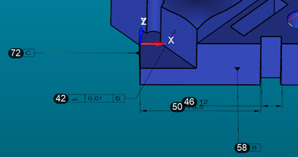

You can use the Characteristic IDs icon (
on the Graphic Items toolbar to show and
hide CAD GD&T characteristic IDs on CAD GD&T callouts. A characteristic
ID on a callout is a unique identifier assigned to the CAD GD&T
by the native CAD software. You can only see a characteristic ID if
its corresponding CAD GD&T is also visible.
For information on the Characteristic IDs icon on the Graphic Items toolbar, see "Graphic Items Toolbar" in the "Using Toolbars" chapter of the PC-DMIS Core documentation.
Example of Characteristic IDs
You can modify the font size with the Graphic Font on the Font Setup dialog box. The font Color on that dialog box controls the background color of the characteristic ID. The foreground color automatically uses black or white to maintain good contrast.

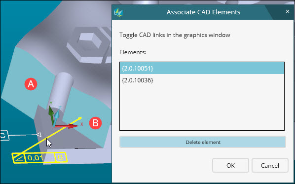

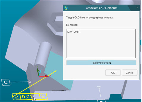

Choose the Associate CAD elements shortcut menu to see the current association in the Associate CAD Elements dialog box.
GD&T callout initially associated to a single element
With the dialog box open, from the CAD model, click on a CAD element. PC-DMIS highlights the selected CAD element and adds it into the Elements list.
GD&T callout now associated to both elements (A and B)
Click OK to confirm the change.
