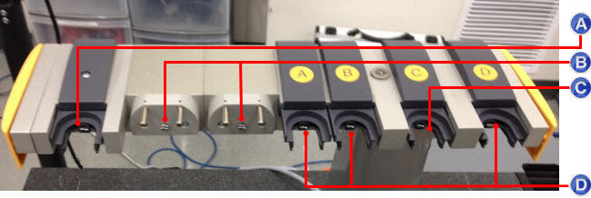

The TESASTAR-R / HR-R rack has four types of ports:
Types of ports:
A - MOD .65: Has a circular
port
B - HD: Has a port with two pins for changing
the HD components
C - Center Post: Has a circular port and is mounted
on the probe changer post
D - MOD .40: Has a circular port

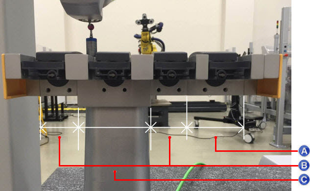

Another image of the ports on the TESASTAR-R / HR-R rack appears below:
Types of ports:
A - MOD .65
B - MOD .40
C - Center Post

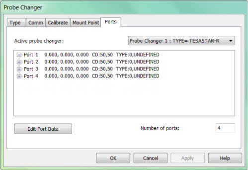

Select the Ports tab in the Probe Changer dialog box (Edit | Preferences | Probe Changer):
Probe Changer dialog box with undefined ports
In the Active probe changer list, select TYPE=TESASTAR-R.
In the Number of ports box, type the number of ports that you want to define. This should match the number of physical ports on the probe changer.
Click Apply to store this parameter.

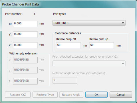

Select the port item in the list and then click Edit Port Data to display the Probe Changer Port Data dialog box:
In the Probe Changer Port Data dialog box, if Port type shows UNDEFINED, select the appropriate type for the port.
Click OK to return to the Probe Changer dialog box.

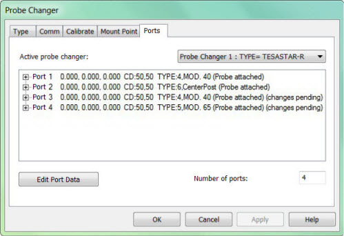

Probe Changer dialog box with all ports defined
