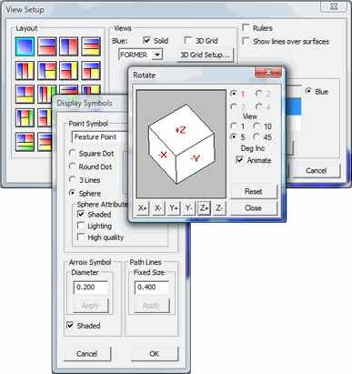

Dialog
Boxes - Access a dialog box. Press F1 while the
dialog box is open and has the focus in Windows. PC-DMIS
displays the Help topic associated with that dialog box. Some dialog
boxes contain multiple tabs, and you want to access the Help topic
for a specific tab. To do that, first click an item on that tab (such
as an option button, list box, check box, and so on) to give that
tab the routine focus, and then press F1.

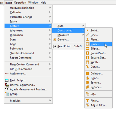

Menu
Items - Hover your pointer over a menu item (not
over a menu heading) on the menu bar. Press F1. PC-DMIS
displays the Help topic associated with that menu option.

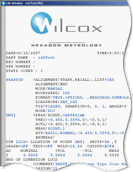

Commands
- Access the Edit window. Place it into Command Mode. Click on a command,
and press F1. PC-DMIS displays the Help topic associated with that
command.
