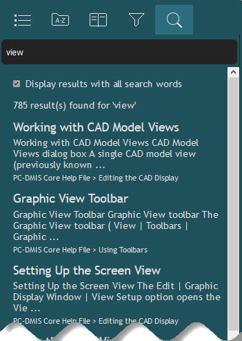

With the Search tab, you can search within titles and topic text for a specific word or phrase.
To use the Search tab, perform the following steps:
From within your software, select Help | Index to access the Help system in your browser.
If the Search tab
is not already displayed, from the toolbar, click the Expand
) to display the Navigation pane.
Click the Search tab and type what you want to search for in the -Search- box. If you place the text in quotation marks, the Help system attempts to find that exact phrase. Otherwise, by default, the Help system tries to find topics with all the search terms in any order. To find even more topics, you can clear the Display results with all search words check box under the -Search- box to show results with partial matches.
From the list of possible matches that appear, click a topic from the list to view it in the Topics Pane. The Help system highlights all the terms that match your typed selection. You can scroll down the list of topics to load more topics that the search found.

We use Adobe's RoboHelp to generate our HTML5 Help content. Adobe's search functionality has an issue or bug where it sometimes returns a less-than-helpful "No Results Found" message. There is a workaround.
The workaround is to put quotation marks around your search word or phrase. That seems to kick the search engine to yield results.
