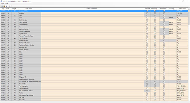

Setup K-Field Configuration dialog box

You can edit columns that are a light-brown color. You can change the values of some drop-down lists in these areas. To do this, click on a value to select it, and then click on the value again to display the cell's drop-down arrow. You cannot edit anything with a gray background.
For descriptions of the columns, see "Columns and Descriptions".
To identify a K-field with a custom name, type the name in the Custom Field Name column.
To enable a K-field so that it appears in the Q-DAS Configurator application, select the check box in the Status column.
To ensure that a field has a value, select
the check box in the Mandatory column. In
application, any mandatory field that needs a value displays an exclamation
point
To provide a K-field with a list of predefined values, select the check box in the Predefined column. In a later step, these K-fields appear in the Setup Predefined Values dialog box, where you can define the list of values available for each K-field.
To assign a K-field to a Q-DAS catalog, select the K-field's row. The selected row is highlighted in blue. Click the drop-down arrow in the Catalog column, and then select the catalog to use.
The Value From column defines where a K-field's value comes from. Select the K-field's row. The selected row is highlighted in blue. Click the drop-down arrow in the Value From column and then select where the value comes from.
