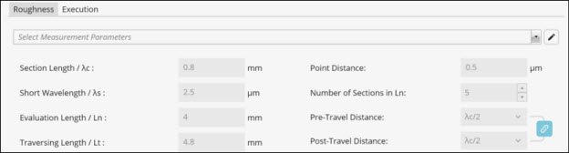

To set the roughness parameters for the Roughness scan command (RGHSCN), select the Roughness tab in the Roughness Scan dialog box (Insert | Scan | Roughness):
Roughness tab

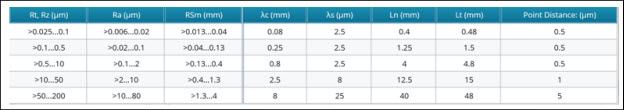

To select roughness parameters based on the ISO 4288 and ISO 3274 standards, select the Select Measurement Parameters list. The parameters appear underneath the list. For example:
Standard
button - To base the roughness parameters on the ISO 4288 and ISO 3274
standards, select this button. If you have selected the parameters based
on the standards, you cannot modify the parameters.
Custom
button - To enter custom roughness parameters, select this button.
The values for Evaluation Length / Ln and Traverse Length / Lt are calculated values. PC-DMIS displays an error if the traverse length exceeds the maximum traverse length. You can modify parameters, including the start point offset, to ensure that the traverse length does not exceed the maximum traverse length.
