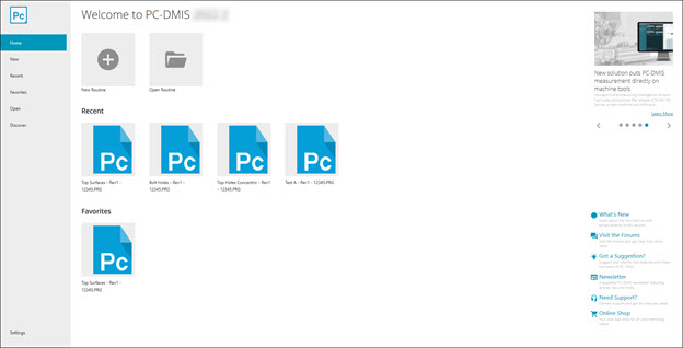

You can open measurement routines from the Home page or from the File | Open menu option.
Using the Home Page
The Home page is discussed in the "Home Page" topic of the "Navigating the User Interface" chapter:
Home Page

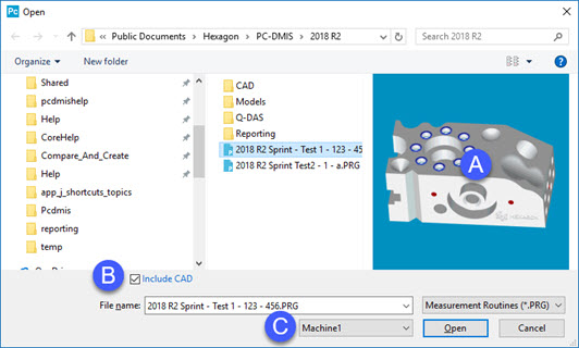

Using the File Open Dialog Box
You can use the Open dialog box to locate and open a measurement routine.
To open the Open dialog box, select File | Open.
If you open a measurement routine in this version that was created in a version prior to version 3.2, it will no longer function in the older version. Be sure to create a backup if you intend to use the measurement routine with your older PC-DMIS version.
This dialog box is a standard Windows Open dialog box with the following additions:
Open dialog box
Preview - This area of the dialog box shows the CAD image for the last view of your part in the Graphic Display window (without labels). If your part doesn't have the CAD data, the image displays measured geometry. If you set a thumbnail from "The Right Pane" of the Home page, PC-DMIS displays the thumbnail as the preview image.
Include CAD - This check box determines whether to load the CAD model when you open the measurement routine. If a CAD model is part of the measurement routine that you are opening, click the Include CAD check box. If you clear the check box, PC-DMIS does not load the CAD model when you open the measurement routine.
Interface - This list displays the online machines in your system as well as an Offline option.
If PC-DMIS is running in Online mode, you can select the machine interface to use for this measurement routine (if you have multiple CMMs).
If PC-DMIS is running in Offline mode, you can select the Offline machine option.
The Open dialog box automatically opens each time you start PC-DMIS so that you can open an existing measurement routine. However, if you want to turn off this feature, you can clear the Show Startup Dialog check box on the General tab of the Setup Options dialog box.
