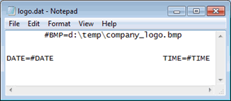

LOGO.DAT – This file defines the header for the very first page of the Edit window. You can define a bitmap with your company's logo, specific date, and time formats.
Edit window's Header Formatting Example
Logo.dat Example in Notepad
That PART NAME, REV NUMBER, SER NUMBER, and STATS COUNT are static fields and cannot be changed in the LOGO.DAT file.

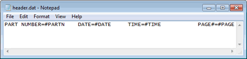

HEADER.DAT – This file is used to format page headers for all other pages.
Header.dat Example in Notepad
For information on how to modify your report's headers or footers with .DAT files, see "Using .DAT Files in Generated Reports".
