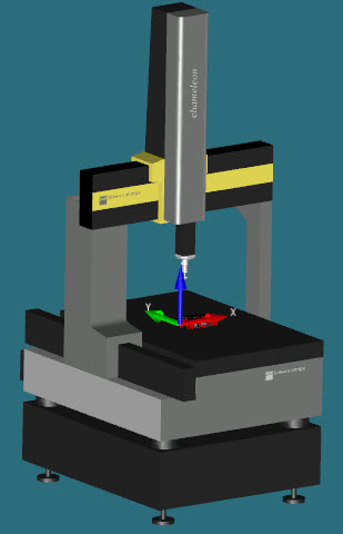

If you use PC-DMIS in offline mode, the Insert | Hardware Definition | Machine menu option displays the Load Virtual Machine dialog box.
With this dialog box, you can select or create a virtual measuring machine or virtual table that is displayed and animated in the Graphic Display window along with the probe and part model.
A sample virtual machine
If you import both a part model and a machine model into the Graphic Display window, and you don't have any outstanding manual machine offsets or rotations, PC-DMIS automatically positions the part model to the machine model's table.

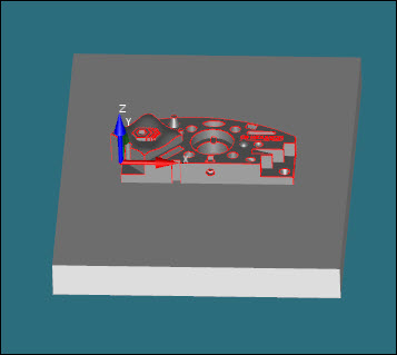

You may not want to show a full virtual machine and instead may only want to display a virtual table (or CMM baseplate). You can do this by choosing an option from the Tables category from the list of machines.
A sample virtual table
The virtual table comes from a list of tables defined in the tablesonly.dat file. You can modify the .dat file to contain tables that match what you need.
