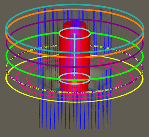

Example
path creation for directly measured Cylinder laser feature when using
an Auto Wrist:
