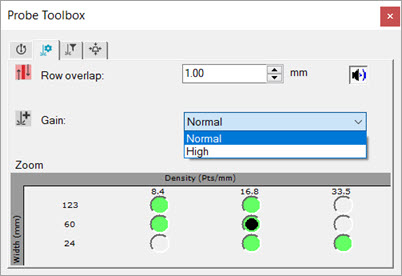

Probe Toolbox - Laser Scan Properties tab showing the Gain options list
HP-L sensors provide you with an additional list called Gain in the Laser Scan Properties tab of the Probe Toolbox.
HP-L-10.6 support NORMAL and HIGH.
HP-L-20.8 supports NORMAL, HIGH, and XHIGH.
HP-L-5.8 supports 1, 2, 3, 4, and 5.
