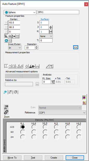

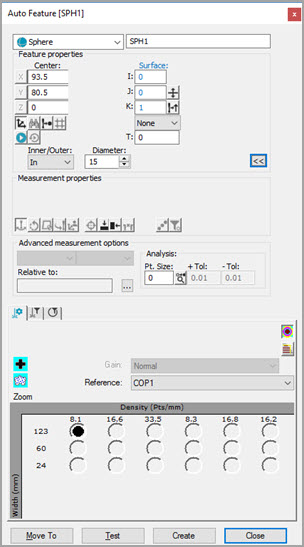

Auto Feature dialog box - Sphere
To measure a sphere with a laser sensor:
Access the Auto Features dialog box, and select Sphere.
From the Inner/Outer box, choose In or Out.
Do one of the following:
Clicks on the CAD to give the sphere a location and vector. Manually enter any remaining information.
From the Graphic
Display window, use the Laser tab to move
the machine to the sphere. Next, from the Feature
Properties area, click the Read Point from
Position button (
). Manually enter
any remaining information, such as the Inner/Outer value, diameter,
and other parameters.
Manually enter the theoretical information for X, Y, Z, I, J, K, Inner/Outer value, diameter, and other parameters.
Enter the necessary information in the Probe Toolbox tabs. Cycle through the Laser Scan, Laser Filtering, and Laser Clipping properties tabs to enter the information.
If desired, click the Test button to test the feature.
Click Create and then Close.
