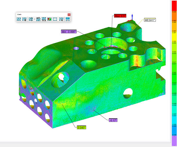

Create MinMax annotations check box - When you select this check box, PC-DMIS creates the minimum and maximum values in the form of annotation labels for the active Mesh Surface Colormap.
Example of mesh colormap with min, max, and various point annotation labels displayed
The software calculates the minimum and maximum points each time you execute the measurement routine.
To show, hide, or delete annotation labels, right-click on a label to display the shortcut menu, and then select the appropriate option.
