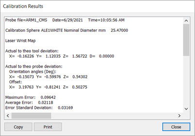

From the Probe Utilities dialog box, click the Results button to show the Calibration Results dialog box.

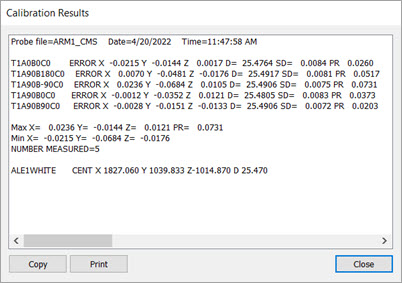

Calibration Results dialog boxes for indexable head after tip calibration (top) and after qualification check (bottom)

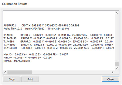

Calibration Results dialog boxes for continuous wrist after wrist mapping (top) and after qualification check (bottom)

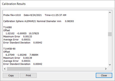

PC-DMIS records several results from the calibration in this dialog box. Look at the maximum, average, and standard deviation values.
The maximum should be somewhere between 20 to 100 microns. The average and the standard deviation should be around 20 microns.
If the values look correct, click the OK button to close the Calibration Results dialog box. You have these options:
