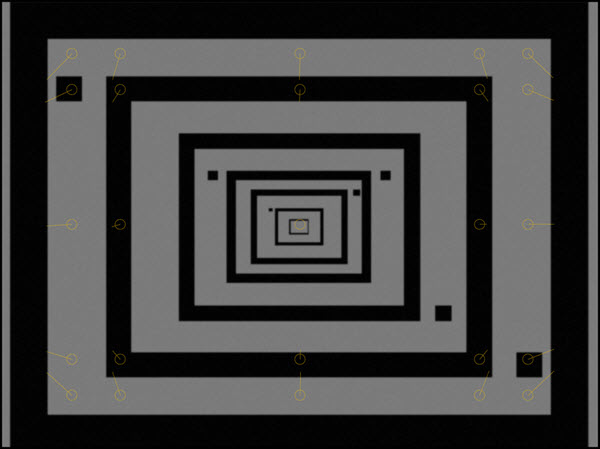

Where a distortion calibration has been performed, PC-DMIS now displays a graphical representation of the distortion calibration results in the live image view. For systems with a zoom lens, it is possible to change the magnification to see the results for that magnification setting.
Example of a graphical representation of the distortion calibration results
