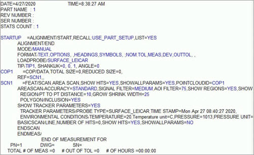

Area Scan example
Example of the Edit window showing the Area Scan command with Region settings
