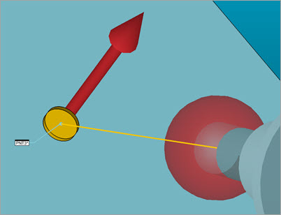

While the probe is outside the probe trigger radius zone, PC-DMIS colors the radius zone yellow:
Example of the Probe Trigger Radius Zone when the Probe is Outside the Probe Trigger Radius Zone
