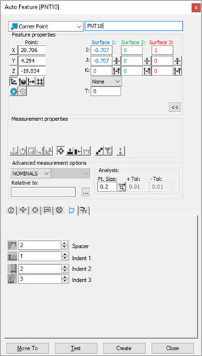

For example, the Auto Feature dialog box for Corner Point shows the three Indent options in the Contact Sample Hits Properties tab of the probe toolbox.
Auto Feature dialog box for Corner Point showing the three Indent options
The Indent values represent the minimum offset distance from the point location to the specified location on each surface.
