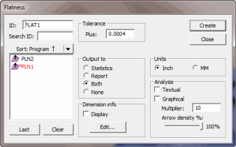

Dimension Flatness dialog box
A minimum of four hits are necessary to determine the flatness of a plane.
The Insert | Dimension | Flatness menu option determines the flatness of a plane. This dimension type is considered one sided, meaning a single positive value tolerance is applied.
