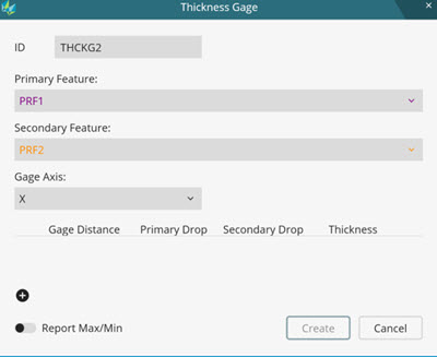

To create a Thickness Gage command:
Create your primary and secondary features.
Select Insert | Gage | Thickness to open the Thickness Gage dialog box.
You can also access the Thickness
Gage dialog box from the QuickMeasure
toolbar (View | Toolbars | QuickMeasure).
Click the Gage drop-down arrow, and then
click the Thickness Gage
button.
Select the primary and secondary features from the respective Primary Feature and Secondary Feature lists. The software populates the list items based on the surface or cut vector of the current alignment.
Select the Gage Axis and define your Point of Interest (POI). For details, see "Point of Interest (POI) Definition and Reporting".
To add the Thickness Gage to your report, click the Report Max/Min button.
Click Create to create the Thickness Gage.

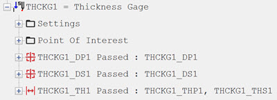

Once you create the Thickness Gage command, the software adds the selected dimensions for the command in the Edit window:
Example of the Thickness Gage command in the Edit window
PC-DMIS considers the dimensions created by the Thickness Gage command to be internal dimensions to the command. Because of this, you cannot delete or cut and paste them in the Edit window.
You can press the F9 key while your cursor is over the internal dimension to display the Thickness Gage dialog box.
PC-DMIS considers the features generated by the Thickness Gage command to be internal commands. Because of this, you can use them in Alignments, Constructions, Dimensions and Assignments.
