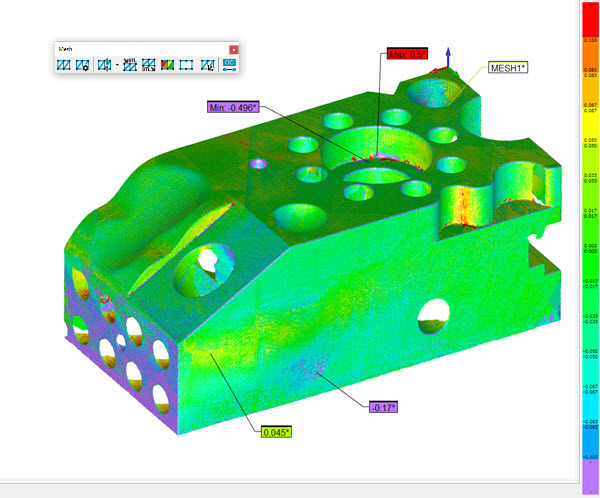

Create annotation points check box - Annotations are a way to display the deviation for a specific location on a surface colormap with its associated color. To create an annotation:
Select the Create annotation points check box. This clears the Select check box in the CAD Controls area and disables most of the options on the right side of the dialog box.
Select a point on the colormapped Mesh in the Graphic Display window. PC-DMIS evaluates and creates an annotation label in the same background color as the Mesh deviation point with the deviation value. You can move the label around in the Graphic Display window as any other label.
Once you create annotation labels, they remain in the same position and have the same characteristics when you restart the measurement routine, or if you restart PC-DMIS and reload the same measurement routine.
Create MinMax annotations check box - When you select this check box, PC-DMIS creates the minimum and maximum values in the form of annotation labels for the active Mesh Surface Colormap.
Example of mesh colormap with min, max, and various point annotation labels displayed
The software calculates the minimum and maximum points each time you execute the measurement routine.
To show, hide, or delete annotation labels, right-click on a label to display the shortcut menu, and then select the appropriate option.
