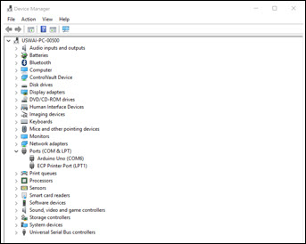

To ensure that the Arduino UNO appears as a COM port, do the following:
Open Device Manager.
Ensure that the Arduino UNO appears as a COM port:
