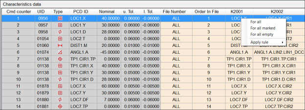

Copying a Value to Other Cells
To copy a value to other cells, follow these steps:
Click on the value that you want to copy to select it.
Right-click on the value, and select the desired option:
Shortcut menu
For all - This option copies the selected value to all of the cells in that column.
For all marked - This option copies the selected value to all of the cells in that column in the highlighted rows.
For all empty - This option copies the selected value to all of the blank cells in that column.
Apply rule - This option has two rules: A default rule and a specific company rule.
Rules are special definitions that apply to the K2001 and K2002 fields. You can apply the default rule at any time.
To apply a specific company rule, you must name the dimensions and features in the measurement routine according to the company's rules.
The rule is applied to the rows that you highlight.
For more information, see "GM Naming Rules for the K2001 Field" and "GM Naming Rules for the K2002 Field".
If duplicate values exist in any cells for the K2001 field, the cells turn red.

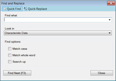

Quickly Finding a Value
To quickly find a value in the Characteristics data area, follow these steps:
Select Edit | Find and Replace | Quick Find to open the Quick Find tab in the Find and Replace dialog box.
Quick Find tab
In the Find what box, type the value that you want to find.
Select the desired options in the Look in list and Find options area.
To find the next value, click Find Next, or press F3.

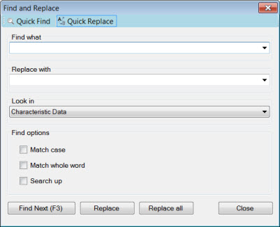

Quickly Replacing Values
To quickly replace a value in the Characteristics data area, follow these steps:
Select Edit | Find and Replace | Quick Replace to open the Quick Replace tab in the Find and Replace dialog box.
Quick Replace tab
In the Replace with box, type the value that you want to replace it with.
To replace the value, click Replace. To replace all values, click Replace all.
