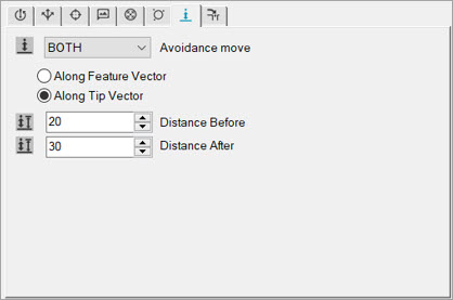

You can find the Distance Before and Distance After options on the Contact Auto Move Properties tab of the Probe Toolbox:
You must verify any measurement routine that uses the Distance Before and Distance After settings for collision detection if you intend on running it on an earlier version of PC-DMIS that only supports the Distance Before option. PC-DMIS uses the smaller of the two values for versions that only support the Distance Before option, which may result in a hardware crash.
