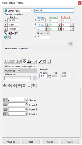

For example, the Auto Feature dialog box for Corner Point shows the three Indent options in the Contact Sample Hits Properties tab of the probe toolbox.
Auto Feature dialog box for Corner Point showing the three Indent options
The Indent values represent the minimum offset distance from the point location to the specified location on each surface.

Corner Point
The PTP_Indent value corresponds to the Indent 1 option and is the offset distance from the point location to the sample hits on the first of the three planes.
The PTP_Indent2 value corresponds to the Indent 2 option and is the offset distance from the point location to the sample hits on the second of the three planes.
The PTP_Indent3 value corresponds to the Indent 3 option and is the offset distance from the point location to the sample hits on the third of the three planes.
