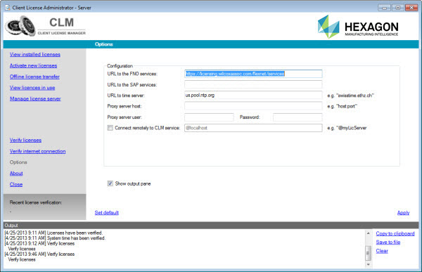

Updating the License Server Configuration is done through the View Licenses dialog box.
To display the View Licenses dialog box:
Double-click clmadminsvr.exe to start the application in your software package to display the main dialog box.
Click the View Licenses dialog box. The list of licensed products will be empty because the required product license was not found.
Click the Options link along the left side to display the server's configuration settings that are used to update the License Server Configuration.
The current local license server configuration appears in the Configuration section of the Options dialog box.
To update the local license server configuration:
Type the new server information as needed. This information is indicated in the CLM Administrator Server under "Manage license server" in the "Managing the Local License Server" chapter.
Click Apply located in the lower-right area to identify the address of the new host.
The Local Client now connects to the new Local License Server.
