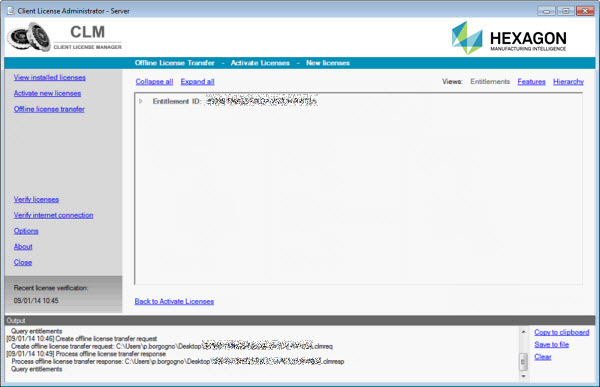

Complete the offline license activation procedure by transferring the activation .clmresp file back to the computer you are licensing. The CLM application processes the file.
  1. Use the appropriate desktop shortcut created with the software installation to start the CLM application on the computer you are licensing:
  1. Select Offline license transfer from the CLM dialog box's main area, or from the menu on the left.
  1. You must use the correct CLM Administrator tool described in step 1 to select the .clmresp file. Select Activate new licenses from the next dialog box, and then click Select Response.
You cannot reuse a .clmresp file that has already been processed. When returning or updating a license, you must generate a new .clmresp file.
If you have lost the generated .clmresp file, the latest one may still be available on the Hexagon Network License Server for one month. Click Query Response to download the latest .clmresp file from the server.
  1. Browse to the .clmresp file stored on your portable storage device. Click it to select it, and then click OK. The CLM Admin application processes the activation .clmresp file and performs the license activation.
