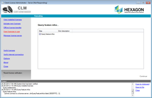

To view the licenses that are currently in use on local client or clients:
Start the CLM Administrator Server (refer to the "Managing the Local License Server" chapter).
Select View Licenses in use from the menu on the left.
If any licenses are currently used on local client or clients, they appear. The user currently using each license is also included.
