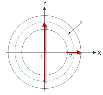

Top-down view of a torus. Note the major diameter (1), the minor diameter (2), and the center line circle (3).
