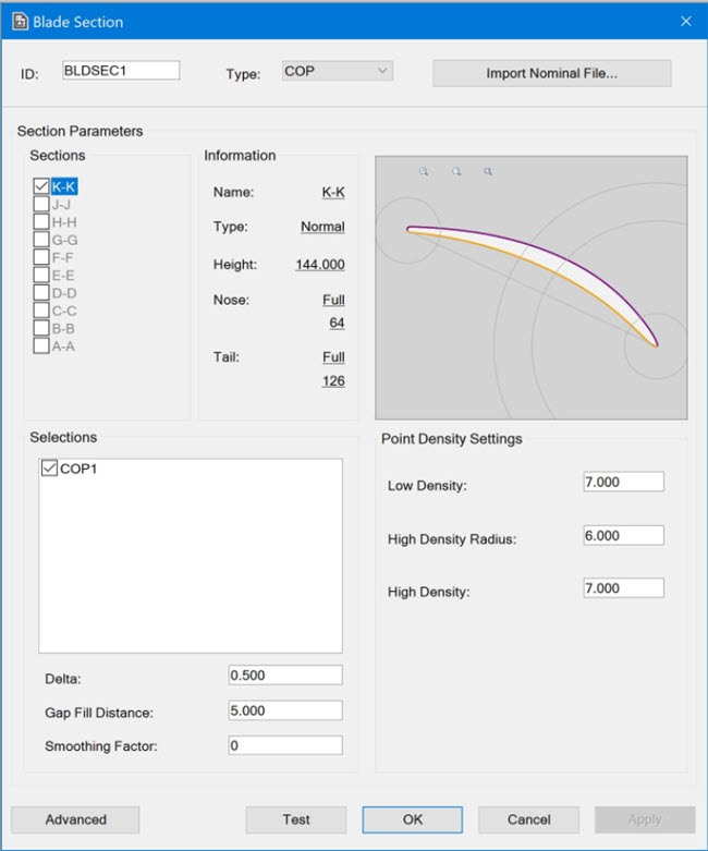

  1. To construct blade sections, select Insert | Modules | Blade Section to open the Blade Section dialog box. Here is an example:
  1. Complete the items in the dialog box.
  1. To create this Blade Section command and insert it in the Edit window, click OK. The Blade Section dialog box also closes.

    PC-DMIS reads the Nominal file and display the information from it in the appropriate parameters in the Section Parameters area. When you import the Nominal file, the Blade Section command refers to the Blade Scan Lookup Table (BladeScan.LookupTable.xml) and inserts the suggested point density for the chord length of the blade. You can then modify these parameters. For more information about the table, see "Modifying the Blade Scan Lookup Table".
    You can use the Blade Section command to section full sections, partial sections, square sections, and skew sections.
    Sections area
    This area displays all of the blade section names in the Nominal file that you imported. The Blade Section command sections (constructs) only the blade sections that are selected in this area. By default, all of the blade sections are selected for sectioning (constructing). If you do not want to section (construct) a certain blade section, clear its check box. To select a blade section, click its check box.

    Information area
    This area displays the parameters for the blade section that you selected in the Sections area.
    View area
    This area displays the CAD model for the blade section that you selected in the Sections area. (If you selected two or more sections, the View area is blank.) These zoom options are available:

    Selections area
    This area displays all of the available COPs or Mesh in the measurement routine.
    Delta box - Applies to the COP type only. This value is the distance within the section height that the Blade Section command looks for points in the COP.
    Gap Fill Distance box - Applies to the COP type only. This box displays the current setting for the CrossSectionMaximumEmptyLength entry in the Settings Editor application. For more information, refer to the documentation for the Settings Editor application.
    Smoothing Factor - When this value is set to 0 (zero), a very small internal smoothing factor is applied.
    When you use the Smoothing Factor, PC-DMIS applies a Least Square fit with a smoothing constraint to an ordered set of points.
    For more information, refer to the "CROSS SECTION" topic in the PC-DMIS Laser documentation.
    Low Density Zone, High Density Zone , and High Density Radius areas
    Low Density Zone - This zone defines the default point density for the blade section. This can be set equal to the point density required in the middle part of the blade.
    High Density Zone - This zone defines the points near the tail and nose area. The points at a higher density are required to measure the sharp ends accurately.
    High Density Radius - This zone defines the high density point zone. Type the radius value with tail or nose points as the center. High density zones display as circles in the View area.
    Test button
    Click this button to perform a test scan of a blade section as follows:
    1. Select the desired section(s) in the Sections area.
    2. Click the Test button.
    Apply button
    Click this button to set all of the parameters for each blade section that you selected in the Sections area.
