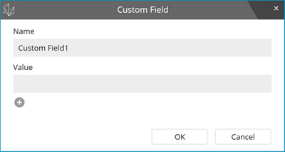

To create a custom field, click the Add button (on the right side of Custom Fields) to open the Custom Field dialog box.
Name - This box defines the custom field's name.
Value - This box defines the custom field's value. You can have a single value or multiple rows of values. To add a row for a value, click the Add button . After you add a row, PC-DMIS adds a check box and a Remove button () for each row. To set a value as the selected value, mark the check box next to the value. In the Data tab, PC-DMIS displays this value as the selected value for each dimension. For a single value, the row for each dimension displays a box where you can type or edit text. For multiple values, the row for each dimension displays a list.
OK - This button creates the custom field.
To edit a custom field, click the custom field's name, and then click Edit () to open the Custom Field dialog box.
To remove a custom field, click the custom field's name, and then click Delete (). After you delete the custom field, the column turns red in the Data tab.
Cancel - This button discards your changes.
