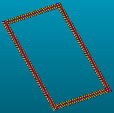

Sheet metal - Select this option for sheet metal parts which mainly have freeform surfaces.
Example of a sheet metal part for UniScan
