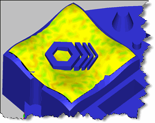

Example of a surface plot of a patch scan
