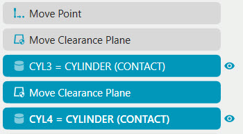

From the Edit window, select CYL3, the clearance plane below it, and CYL4:
Cut and paste those three commands so that they are now below the second MOVE/POINT command.
Check your work. The last part of your Edit window from CIR9 down, should look like this:
