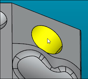

Turn on the above items for a Cylinder Auto feature.
Ensure that surfaces are not selected.
Press Shift and click on the inner cylinder on the slanted surface on the top face.

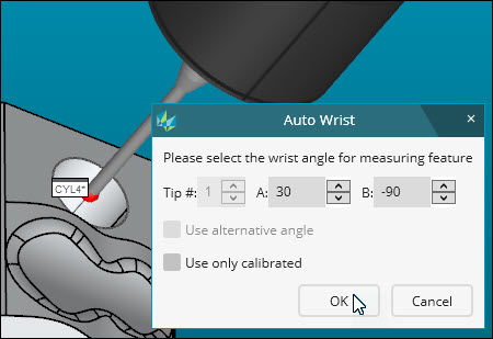

The animated probe in the Graphic Display window positions itself in the cylinder. The software displays the Auto Wrist dialog box to select the best angle:
Click OK to add CYL4 into the routine and close the Auto Wrist dialog box.

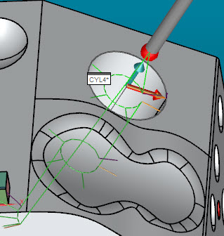

From the Edit window, select the CYL4 feature and press F9. You can see that the path lines between the hits use a curve instead of a straight line:
