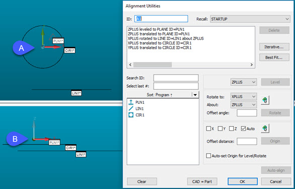

At this point, the Alignment Utilities dialog box and Graphic Display window should look similar to what's here:
At left - Graphic Display window with trihedron in A) Z+ view and B) Y- view
At right - Alignment Utilities dialog box with the current
alignment
When you complete the above steps, click OK to insert the alignment into the Edit window:
Edit window with the new alignment
