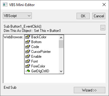

To set properties for the ActiveX control inside the VBS Mini-Editor for an event handler
Type the name of the ActiveX control. For example, if you used the example above, you would type WebBrowser.
Then type a period after it. A window appears so that you can access the variables and methods.
Select the X from the list. PC-DMIS opens another popup window that lists a set of internal editable variables for the ActiveX control.
In this ways you can access an Active X object's methods, properties, and events.
