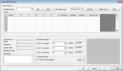

The Insert | Hardware Definition | Fixture menu option opens the Create/Modify Fixture dialog box.
You can use this dialog box to create and position the columns so that they connect with the part. If you click OK or Apply after you load or create a fixture, PC-DMIS inserts a LOADFIXTURE command into your measurement routine. This command loads and uses the selected fixture definition.

You can use the Fixture Points tab to fully define and deploy a fixture. With this tab, you can create and manage fixture definitions and position fixture columns so that they can properly hold your part for proper measurement.
A standard fixture definition contains this information:
Fixture name
Fixture contact point locations (XYZ and IJX values)
Feature type
Module offset type and information
Column name
Fixture creation date, modification date, and author information
Machine orientation
