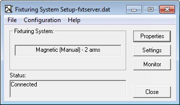

Select the Flexible Fixturing system to configure from the list box in the Select System dialog box. Enter values in the Number of Arms and Machine Type boxes. You should specify two arms for the master/slave mode of a dual-arm system. Click OK to accept any changes that you made. The Fixturing System Setup dialog box appears with the changes.
Fixturing System Setup dialog box - dual arm

Click Properties in the Fixturing System Setup dialog box and edit the properties for both Arm1 and Arm2.
Press F12 to open the Fixturing Setup dialog box in PC-DMIS. Make the appropriate changes on each tab.
