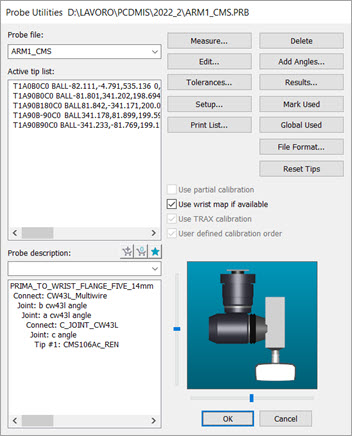

Probe Utilities dialog box for an indexable head

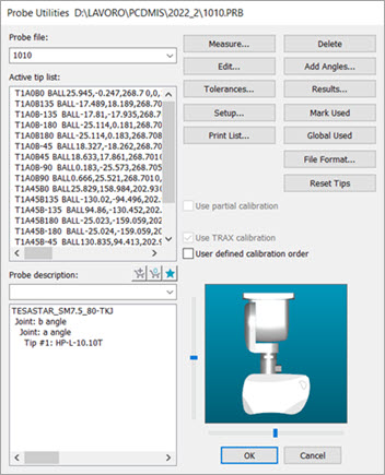

Probe Utilities dialog box for the CW43L
In the Probe file box, type a name that best describes your laser sensor.
From the list of components at the bottom, select the No probe defined text to highlight it.
From the Probe Description list, select the appropriate probe. You can mount the CWS or WLS sensor on a wrist with a TKJ connector, or on OPTIV_FIXED on multi-sensor machines.
As needed, select additional components in the same manner for "empty connections" until you finish defining the probe. A defined probe shows a tip in the Active Tip List.
