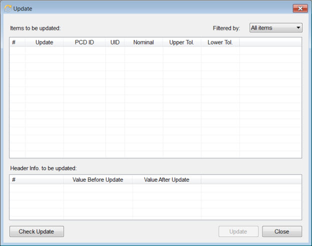

From Q-DAS Configurator, select File | Update to open the Update dialog box.
Update dialog box
Click Check Update. Q-DAS Configurator reads the measurement routine, determines the changes, and displays the changes in the dialog box. The processing time varies and depends on the size of the measurement routine.
To filter the changes, select the desired option in the Filtered by list: All items, Added items, Removed items, or Modified items.
The Update column then displays the type of update. The changes in the header of PC-DMIS appear in the Header Info. to be updated area.

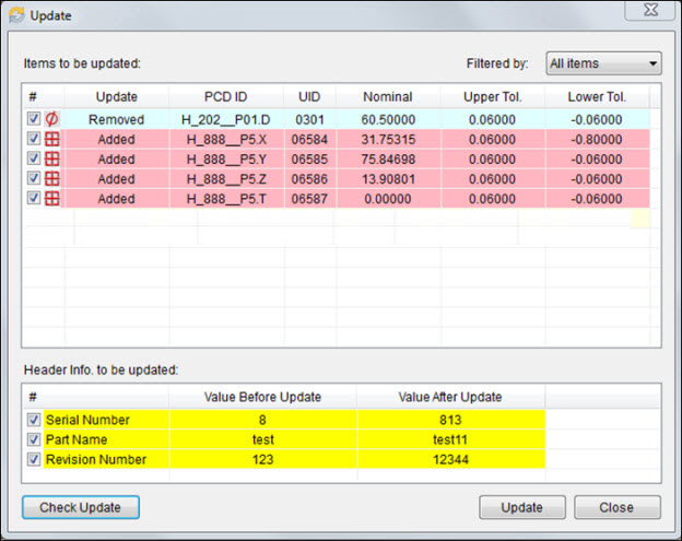

Example of Update dialog box

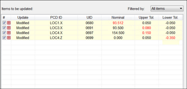

The values that you modified appear in red.
Example of modified values
