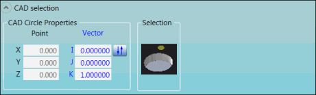

LA, LB, LD, LE, LF, and LG features:
CAD selection group for LA, LB, LD, LE, LF, and LG features

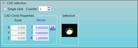

LC feature:
CAD selection group for LC feature

Item |
Description |
Single click check box |
To enable single-click CAD selection, click this check box. To enable multi-click CAD selection and display the Counter list, clear the check box. |
Counter list |
Select the number of ESF features of this type in the measurement routine. |
CAD Circle Properties area |
X, Y, and Z Point boxes: These boxes display the calculated point locations on the CAD model. I, J, and K Vector boxes: These boxes display the calculated vector locations on the CAD model. |
Selection area |
This image displays the navigation path. |
