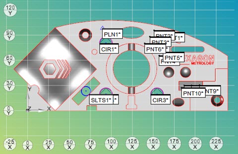

Example of a 3D Grid with Label Inset of 10 pixels in the X-Y Plane

PC-DMIS draws only one grid at a time. The grid drawn depends on the axis plane rotated closest to your screen (determined by the axis indicator). For example, the following axis indicator from the Graphic Display window shows the X-Y axis plane facing the user; PC-DMIS draws the X-Y axis grid.
Axis Indicator showing the X-Y plane.
