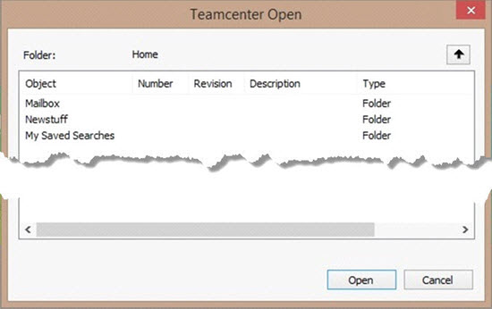

  2. Choose File | Open to open a measurement routine from Teamcenter.
  3. If PC-DMIS establishes a connection to Teamcenter, a unique Teamcenter Open dialog box opens. Use the dialog box to help you navigate through your Teamcenter database. It shows a list of folders and files stored in the database.
  1. Click on a folder's name to open that folder. Click on folders as needed to navigate to a directory that holds PC-DMIS measurement routines.
  2. Use the Type column to see what type of object you're working with: A "Folder" type means the object is a folder. A "Part Reference" type means the object is a measurement routine. If you need to go up a directory, above the list of folders, click the black up arrow.
  1. Select a measurement routine (a "Part Reference"), and click Open to open the measurement routine in PC-DMIS.
