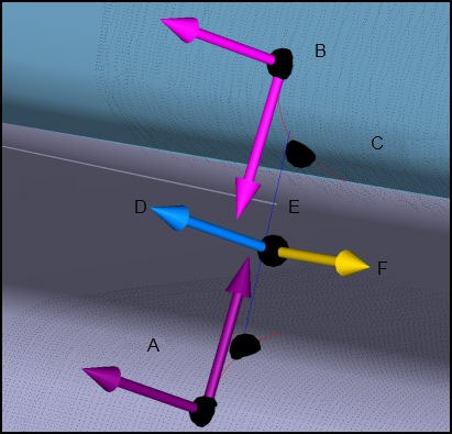

With CAD Data
Load a CAD model.
Click on the Master side.
Click on the Gauge side.
A - Master
B - Gauge
C - CAD learned curves
D - View Vector
E - Depth line
F - Cut Vector
These points must be on the reference "flat" surfaces, where PC-DMIS sets the planes used to calculate flush, and not on the curves.
PC-DMIS learns the theoretical Flush.
PC-DMIS learns the curves from the CAD model.
PC-DMIS learns the point coordinate and vectors for both the Master and Gauge sides of the gap.
PC-DMIS applies the defined Depth value, and after piercing the curves it calculates the theoretical gap at the specified depth.
PC-DMIS also calculate the cut vector (along the rail) and the Gap direction (crossing the rail).
