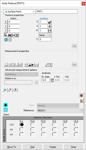

Auto Feature dialog box - Surface Point
To measure a laser surface point with a laser sensor:
Access the Auto Feature dialog box (Insert | Feature | Auto | Point), and click Surface Point.
Do one of the following:
Click the CAD in the Graphic Display window to give the point a location and vector. Manually enter any remaining information.
From the Graphic Display window,
use the Laser tab to move the machine to
the point location. Next, from the Feature Properties
area, click the Read Point from Position
button (). Manually
Manually enter the theoretical information for X, Y, Z, I, J, K, and so on.
Enter the necessary information in the Probe Toolbox tabs. Cycle through the Laser Scan Properties, Laser Filtering Properties, and Laser Clipping Region Properties tabs to enter the information.
If desired, click the Test button to test the feature.
Click Create and then Close.
