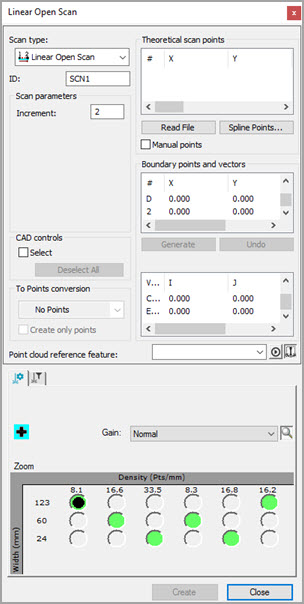

Linear Open Scan dialog box
The Linear Open Scan method scans the surface along a line. This procedure uses the starting and ending points for the line, and also includes a direction point for the calculation of the cut plane. The probe always remains within the cut plane while doing the scan.
