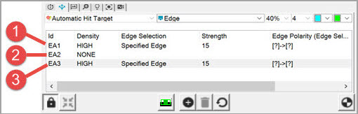

The resulting targets are defined in the Probe Toolbox of the Auto Feature dialog box for your Line feature.
Results of hits in the Probe Toolbox
In the image above:
1 - Target is defined from clicks 1 and 2
2 - Target is defined from clicks 2 and 3
3 - Target is defined from clicks 3 and 4

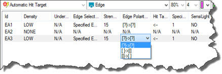

Click in each of the Edge Polarity fields to change the settings as necessary.
Changes made to the last Active Target causes the automatic execution to restart.
