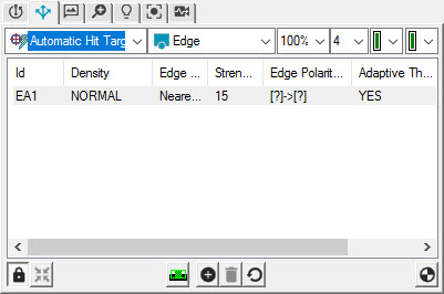

To use Target mode for large features:
Click the Large Feature
Mode icon
located along the bottom of
the Hit Target tab in the Probe
Toolbox in the Auto Feature dialog
box for the Line feature.
The Large Feature Mode option is only available with the Automatic Hit Target type.
When you close PC-DMIS, the state of the button is saved. The next time you start PC-DMIS, the button is in the same state ("On" or "Off") it was in when you last closed PC-DMIS.
Click the button to toggle it between the "On" and "Off" states. Each time you toggle the button, a Warning dialog box displays.
