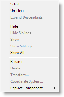

A shortcut menu appears when you right-click in the tree view. The shortcut menu contains these items:
Select - This item functions as if you had double-clicked on the assembly component.
Unselect - This item deselects the assembly component in the Graphic Display window.
Expand Descendants - This item expands an assembly to show a list of child parts making up the assembly.
Hide - This item hides the selected component.
Hide Siblings - This item hides all of the components except the selected component at the same level on the assembly tree.
Show - This item shows the selected component.
Show Siblings - This item shows all of the components except the selected component at the same level on the assembly tree.
Show All - This item shows all the components on the assembly tree.
Rename - This item renames the selected component in the assembly.
Delete - This item deletes the selected component from the assembly and removes it from the Graphic Display window. You cannot delete the root tree view component.
Transform - This item displays the CAD Transform dialog box. This dialog box allows you to transform (translate, scale, and rotate) a single component in the assembly. You cannot transform the root tree view component. For more information, see "Transforming a CAD Model".
Coordinate System - This item displays the CAD Coordinate System dialog box. This dialog box lets you create and manage different coordinate systems. For more information, see "Working with CAD Coordinate Systems".
Replace Component - This item allows the selected assembly component to be replaced with another CAD model. This model can either be an imported CAD model or a model connected with the DCI. The sub-menus have the same structure as the File | Import and File | Direct CAD Interface menu options respectively. The new model replaces whatever model is associated with the selected node. The new model on the node retains any transformation that was applied to the previous model. For information on how to import model files, see "Importing CAD Data or Feature Data" in the "Using Advanced File Options" chapter.

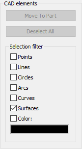

CAD Elements
The CAD Elements area lets you select CAD objects and move them to a different part. You can select or deselect CAD objects within the Graphic Display window. To do that, click on them individually, or for multiple CAD objects, drag a box around them.
Move To Part - This button moves the selected CAD objects to the currently selected part in the Assembly Tree View.
Deselect All - This button deselects all previously selected CAD objects.
Selection Filter - This area lets you filter the CAD objects that PC-DMIS can select. If an item is selected, PC-DMIS has the ability to select that type of CAD object when you click or box-select CAD objects in the Graphic Display window.
You can also filter the selection by the color of the CAD object. If you select the Color check box, the color of the next CAD object that you select in the Graphic Display window is then used as the filter color. For subsequent selections, you can only select CAD elements with that color.
